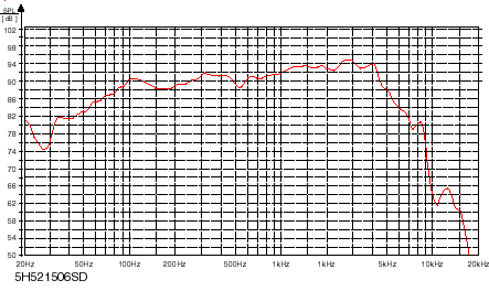

    Flexunits 5 H 52 15 06 SD
    Effective Cone Area 137 Cm2
    Nominal Impedance 8 ohm
    ResonanceFrequence 40Hz
    Equivalent Air Volume28.5Ltrs.
    Mecanical Q Factor1.8
    Electrical Q Factor0.39
    Total Q Factor0.32
    Acceleration Factor499
    Nominal Power Handling150W
    Efficiency89dB
    Frequency response42-4300Hz
    DC resistance5.6Ohm
    Compliance1.0846mm/Nm
    Mechanical res.2.038Kg/s
    VC inductance0.13mH
    Moving mass14.60g
    Force factor7.26N/A
    Linear excursion (x-max)5.2mm
    Max. excursion (P-P)32mm
    magnetas 131 cm
    svoris apie 5 kg
    Frequency response
    specialiai skirtas vidutiams dazniams, bukle ideali. Kaina 200 euru uz abu garsiak. Nauju kaina is Danu tris kart brangesne jie taiko pvm +siuntimas .
    placiau www.audiotechnology
